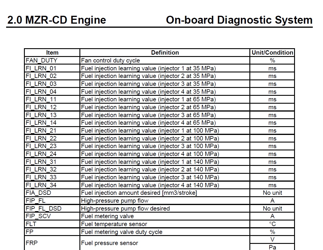

I wanted to ask whether it is possible to calculate the fuel consumption by diesel injectors? (diesel engine is a direct injection (car MAZDA 5))
Thanks
Thanks
Re: Consumption method
Unfortunately I haven't seen any diesel vehicles, who report injector pulse width sensor value. Thats the actual problem.
I'm not sure, but maybe these data are suitable for the calculation of fuel consumption
