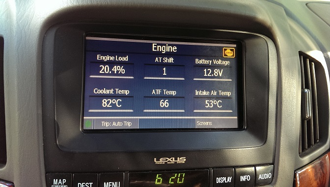

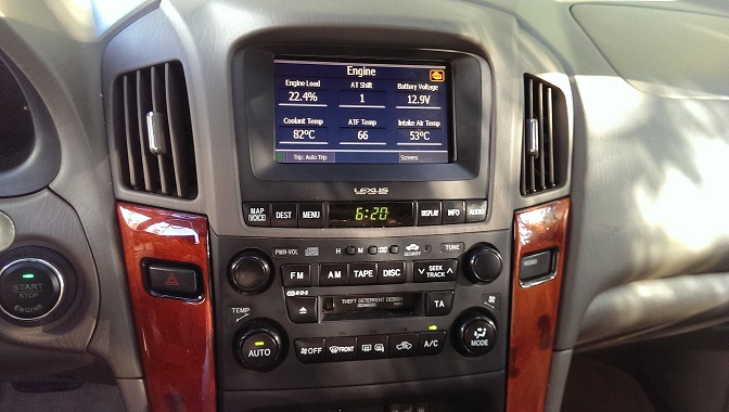

The images above are small example of what I'm talking about:
In the first place, how I tried to improve the looks with my very little knowledge of Photoshop and second, if you notice, the check engine light in the left upper corner. The message says "Low Fuel Efficiency". What the hell?!!
As you see, I don't have any fuel sensor on the screen. This is my only screen. Why the program is showing me that?
And on the other hand, I'm driving 2 kilometers per day, 2 tons, 4x4, 3000cc machine in rush hour in the center of the city, with climate control ON at near 40 degrees Celsius...What fuel efficiency do you what me to have?
