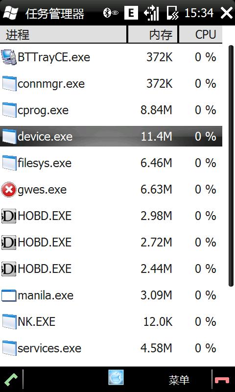

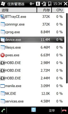

When HOBD exit,it not real quit,there is HOBD.exe still in memory,I mean,if I run the HOBD 3 times,and exit 3 times,there is three HOBD.exe in system process.

Thanks, thats a known issue. Do you know what .net environment version is installed on your device?
We've seen this to be .net 3.7 specific issue, and not reproducible on .net 3.5.
Re: A problem on WM6.5
uninstall .net CF 3.7 and reinstall .net CF 3.5,it`s ok now
