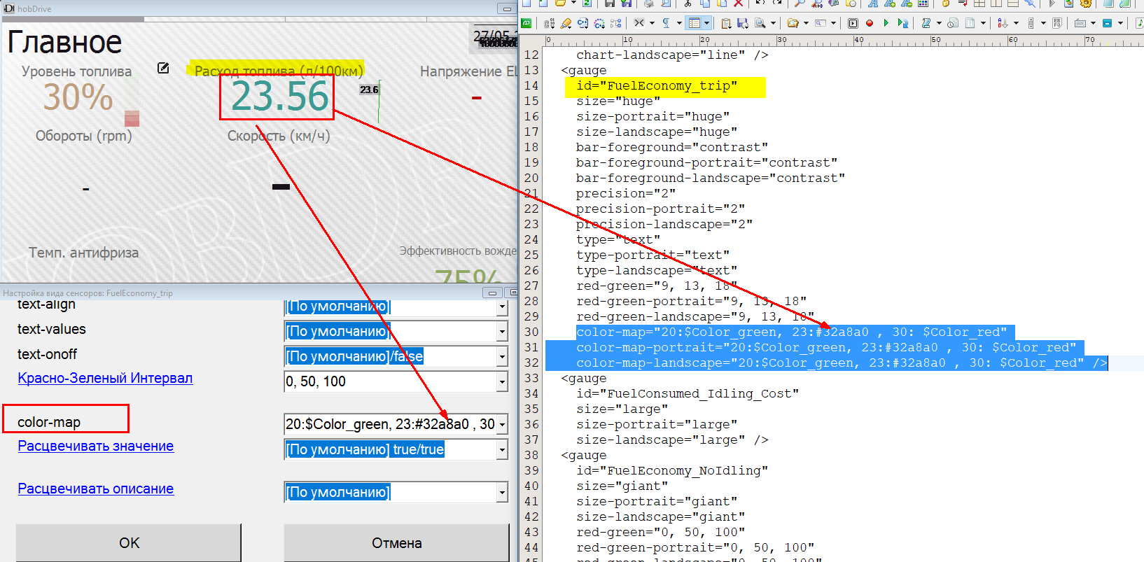

Long tap on Fuel Econmy/edit sensor
Re: Font Colors
I do that but it does not appear to have any effect.
I really want to change the Red Green Interval to 20 25 & 30 so that the display will be green up to 20 and red when over 30.
I set the numbers then press ok but it does not appear to be saving the new parameter.

Have you demo or full version?
Re: Font Colors
I have the Full paid version.
Any of the other changes I make in Fuel Economy Edit sensor do take effect except for the Red-Green interval custom setting (Red-Middle-Green). If I choose one of the preset settings (ie 6,10,15) it does take effect ok.
But I have a vehicle with high Lt/100km so I want to use 20 30 30 values.

put here the user.gauge files from the folder hobdrive

Add in user.gauge code:
PS. del ".txt" attache file
- Код: Выделить всё
<gauge id="FuelEconomy_trip, FuelEconomy_NoIdling"
color-map="20:$Color_green, 23:#32a8a0 , 30: $Color_red" />

Re: Font Colors
Bobgibson2908 писал(а):Was the piece of code missing from the original file?
- Код: Выделить всё
<gauge id="FuelEconomy_trip, FuelEconomy_trip_secondary, FuelEconomy_NoIdling, FuelEconomy_secondary_NoIdling, FuelEconomy_WarmEngine, FuelEconomy_NoBattery"
color-map="4:$Color_green, 15: $Color_red" />
in hobdrive.gauge
user.gauge have most prioritet
Re: Font Colors
The original hobdrive.guage file already contains
I realise english is not your first language but I dont understand "user.gauge have most prioritet"
- Имя: Bob Gibson
- Сообщения: 21
- Зарегистрирован: 20 май 2020, 01:03
Re: Font Colors
The contents of the user.gauge file take precedence over the contents of the remaining "* .gauge" files.
Re: Font Colors
I made changes you suggested to the User.guage .
When I check the Fuel Economy setting it shows the red-green interval as 20, 25, 30 Which what I wanted but when I drive the numbers in the Fuel Economy stay red color despite the numbers changing from 17 - 35
Have I missed something else?

Put your user.gauge file here again
Re: Font Colors
user.gauge
- Имя: Bob Gibson
- Сообщения: 21
Re: Font Colors
<gauges>
<gauge
id="DistanceToEmpty"
description="top"
description-portrait="top"
description-landscape="top" />
<gauge
id="*"
chart="line"
chart-portrait="line"
chart-landscape="line" />
<gauge
id="FuelEconomy_trip"
size="huge"
size-portrait="huge"
size-landscape="huge"
bar-foreground="contrast"
bar-foreground-portrait="contrast"
bar-foreground-landscape="contrast"
precision="2"
precision-portrait="2"
precision-landscape="2"
type="text"
type-portrait="text"
type-landscape="text"
red-green="15, 25, 30"
red-green-portrait="15, 25, 30"
red-green-landscape="15, 25, 30" />
<gauge
id="FuelConsumed_Idling_Cost"
size="large"
size-portrait="large"
size-landscape="large" />
<gauge
id="FuelEconomy_NoIdling"
size="giant"
size-portrait="giant"
size-landscape="giant"
units="none"
units-portrait="none"
units-landscape="none"
type="text"
type-landscape="text" />
<gauge
id="IntakeAirTemp"
size="giant"
size-landscape="giant" />
<gauge
id="Speed"
size="huge"
size-landscape="huge" />
<gauge
id="FuelEconomy_WarmEngine"
type="text"
<gauge
id="General:0:0:FuelEconomy_trip"
units="below"
description="bottom"
descr-font-adaptation="true"
text-onoff="false"
units-portrait="below"
units-landscape="below"
description-portrait="bottom"
description-landscape="bottom"
descr-font-adaptation-portrait="true"
descr-font-adaptation-landscape="true"
text-onoff-portrait="false"
</gauges>

- Имя: Bob Gibson
- Сообщения: 21
Re: Font Colors
replace your code
to code
Bobgibson2908 писал(а):<gauge id="FuelEconomy_trip, FuelEconomy_trip_secondary, FuelEconomy_NoIdling, FuelEconomy_secondary_NoIdling, FuelEconomy_WarmEngine, FuelEconomy_NoBattery"
to code
- Код: Выделить всё
