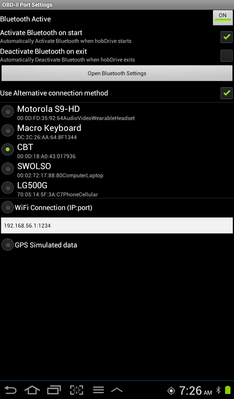

stephenoneufer
Screenshot
Screenshot
Here ia a screenshot of my settings screen. I don't see any other method of connection except the one i am using (CBT on Bluetooth)
Re: Hobdrive on Android Beta
Добавлено: 03 окт 2012, 16:36
Stephen, you should update to 1.1.50 version - it contains an extra "android4" method.
