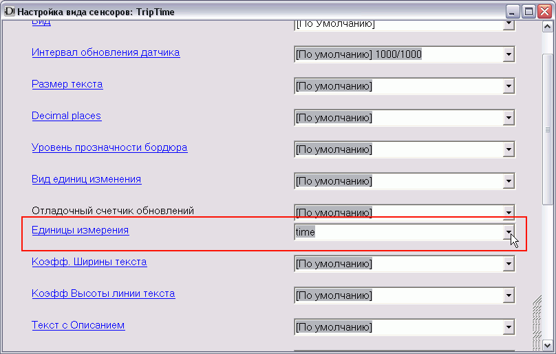

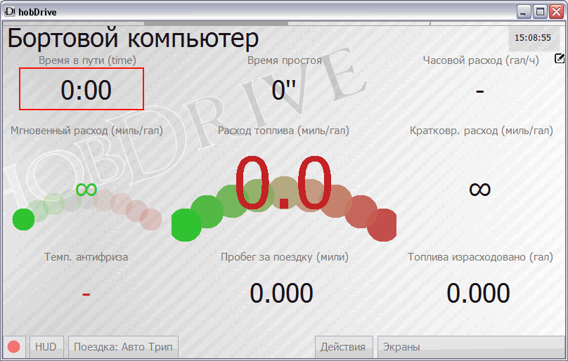

kdika » 26 фев 2015, 16:20
user.gauge:
<gauges>
  <gauge
    id="TripTime"
    custom-units="time"
    custom-units-portrait="time"
    custom-units-landscape="time" />
  <gauge
    id="*" />
</gauges>

Re: TripTime question
cail » 26 фев 2015, 16:39
Think thats a latest beta 1.2.10.
1.1.1 probably had that feature unimplemented.
