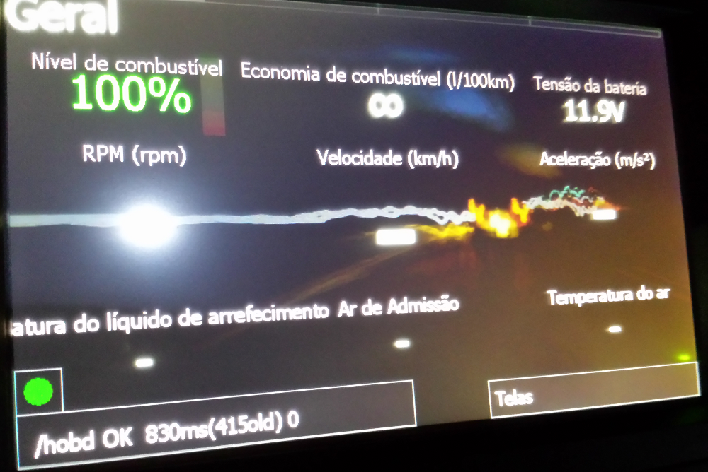

Hi,
my "problem" is that HOBDrive can not communicate with the ECU of my car, a brazilian Toyota Corolla 2011 2.0 Dual VVT-i (3ZR-FE).
Has anyone seen this problem and knows a solution?
Regards!
HOBDrive 1.1.97-Beta + RoadRover MotorOne(M1) WinCE6 800x480 + ELM327BTmini + Kevler Bluetooth(generical) + Toyota Corolla 2011 XEi FLEX 2.0 Dual VVT-i (3ZR-FE)

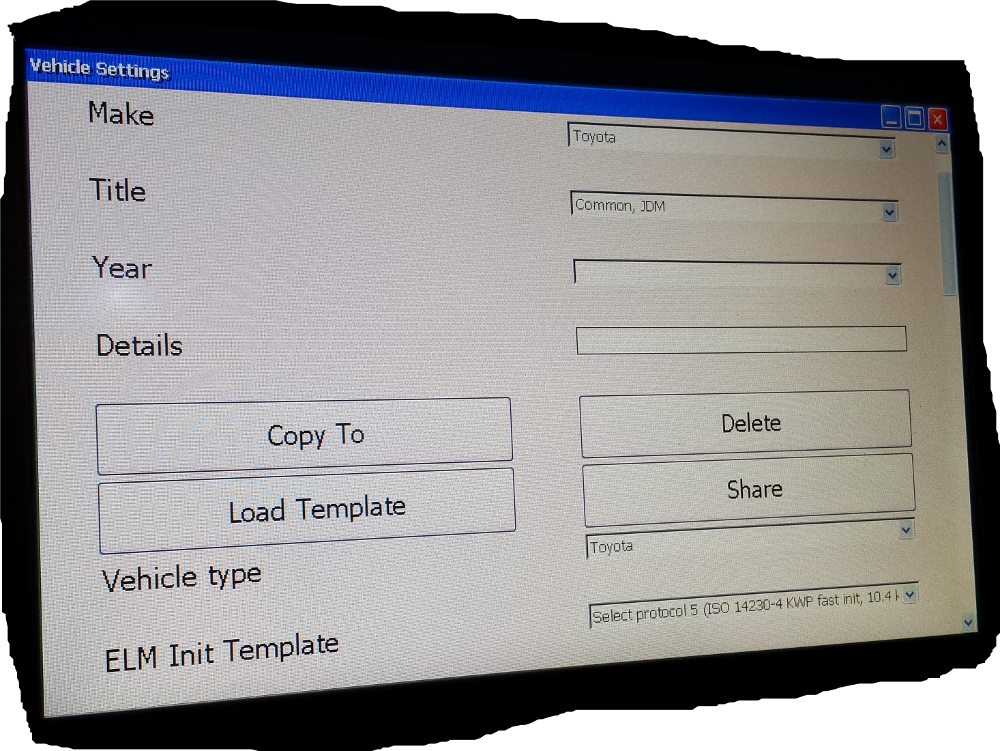

Andy, are you sure hobdrive sees and can reach your ELM adapter? Because it should work absolutely fine with these toyotas.
Сообщения: 4241
Re: HOBDrive not communicate with ECU 3ZR-FE Toyota Corolla
andypeterles » 14 мар 2014, 21:05
Yes Cail, I'm sure. I visualize the LEDs of the device in action during the commands sent by HOBDrive. I also tested with Torque Pro software (Android) and the result is the same, arriving just yet to talk to the ECU. :?
I'm putting a few pieces of logs below:

Please try using "Toyota CAN 21" profile (Open vehicle setttings, "Type" field)
Сообщения: 4241

I got some success by changing the "Vehicle Type" field to "Toyota" and "ELM Init Template" field to "5 Select protocol (ISO 14230-4 ...)".
But, I'm still in doubt when the MPG method because despite seeing the green circle at the bottom left, I only see information about the battery voltage. When accelerating the engine I did not get results on the screen.
Greetings!

cail » 18 мар 2014, 14:15
Please try changing "Vehicle Type" to "Toyota CAN21", ELM init string to the same "Toyota CAN 21"

I do not see the type of vehicle "Toyota CAN21" in combobox. I still lost as to MPG Method and changed MAF to MAP to EngineLoadSensor and nothing was shown beyond the battery voltage and 100% in fuel. :?:
What are the parameters for the type "Toyota CAN21"? I can create a new profile ...
andypeterles » 20 мар 2014, 04:14
Hi guys,
I have not received a return of support department but has found the useragent.dll file and reused in version 1.1.95-Beta folder...
Cail: The CAN21 setup did not work on my car!
Even getting into the mode of self-configuration, not an ideal configuration has been found.
In version 1.1.1 I select the protocol 5 for Toyota JDM and reaches to the noise from the ignition catching but not shows the sensor values​​.
In version 1.1.95-Beta I select the protocol 5 for Toyota JDM and only gives the sound of misfire.
Good job! ;)
cail » 21 мар 2014, 15:35
This means your toyota has some custom unknown ECU.
Could you try choosing different "Toyota JDM" types? There are couple of elm init strings with "JDM" word in them - try choosing different items as well.
If that not help, please post you log.txt file here.

Hello Cail,
I received my new device and everything worked!
See below:
[INFO]  25/6/2014 09:35:18.013[HOBD]  HOBD 1.1.97 Thu 04/17/2014  03:18 AM
[INFO]  25/6/2014 09:35:18.230[HOBD]  Env: 3.5.7283.0
[INFO]  25/6/2014 09:35:20.299[HOBD]  SN: 00540054-0034-0058-0030-545434583042445F3000
[INFO]  25/6/2014 09:35:22.222[HOBD]  Vehicle: My Vehicle
[ERROR]  25/6/2014 09:35:23.506[HOBD]  File Not Found in ecuxml://\Storage Card\Programas\HOBD1.1.97\user.ecuxml : Could not find file '\Storage Card\Programas\HOBD1.1.97\user.ecuxml'.
[INFO]  25/6/2014 09:35:24.719[HOBD]  system width: 800, height: 480
[INFO]  25/6/2014 09:35:24.734[HOBD]  wa width: 800, wa height: 480
[INFO]  25/6/2014 09:35:25.840[HOBDAll]  hobDrive lhxgs6496757<=8=4 - Erhivwsr$Evevmti$Tixivpi
[INFO]  25/6/2014 09:35:26.957[HomePage]  System DPI: 96
[INFO]  25/6/2014 09:35:26.971[HomePage]  App DPI: 57
[INFO]  25/6/2014 09:35:26.978[HomePage]  layout: 475x285
[INFO]  25/6/2014 09:35:26.988[HomePage]  form: 242x293
[INFO]  25/6/2014 09:35:38.059[OBD2Engine]  VersionInfo: ELM327 v1.5
[INFO]  25/6/2014 09:35:38.505[OBD2Engine]  Sensor Init:SEARCHING...
41 00 BE 1F B8 13
[INFO]  25/6/2014 09:35:38.568[OBD2Engine]  ProtocolId: 6
[INFO ]  25/6/2014 09:35:40.666[MILTrace]  dataraw: 43 00
[INFO ]  25/6/2014 09:35:40.760[MILTrace]  dataraw: 47 00
[INFO ]  25/6/2014 09:35:50.974[MILTrace]  dataraw: 43 00
[INFO ]  25/6/2014 09:35:51.092[MILTrace]  dataraw: 47 00
[INFO ]  25/6/2014 09:35:52.002[MILTrace]  dataraw: 43 00
[INFO ]  25/6/2014 09:40:51.174[MILTrace]  dataraw: 47 00
[INFO ]  25/6/2014 09:40:52.208[MILTrace]  dataraw: 43 00
[INFO ]  25/6/2014 09:45:51.357[MILTrace]  dataraw: 47 00
[INFO ]  25/6/2014 09:45:52.403[MILTrace]  dataraw: 43 00
[INFO ]  25/6/2014 09:50:51.556[MILTrace]  dataraw: 47 00
[INFO ]  25/6/2014 09:50:52.456[MILTrace]  dataraw: 43 00
Regards!!
