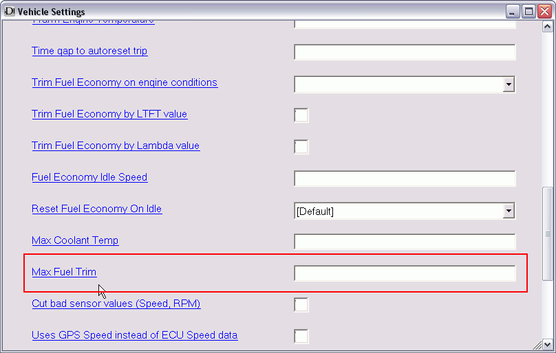

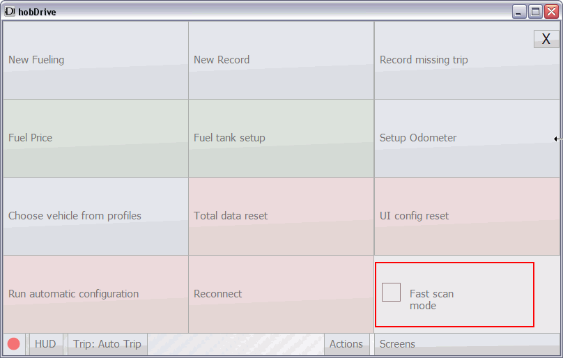

Thanks for the reply. I'll do that but does it mean that for now I have to press the fast mode every time I start the program?
P.S. Sorry but it seems I cannot find these settings: Fast Diagnostic Mode and Low Efficiency threshold. Where they lay?

Re: Some thoughts and suggestions
kdika » 27 авг 2014, 10:04
Low Efficiency
