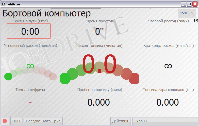

A sensor TripTime accepts only the format X' XX".
When I try to redefine the units to timesec i.e. 0:00:00 or time 0:00 format,
the sensor is not working. Please advice.
Or at least, how to change ' and " to something else because the common
units for expressing period of time are hours and minutes...
P.S. For stable version hobdrive license 1.1.1

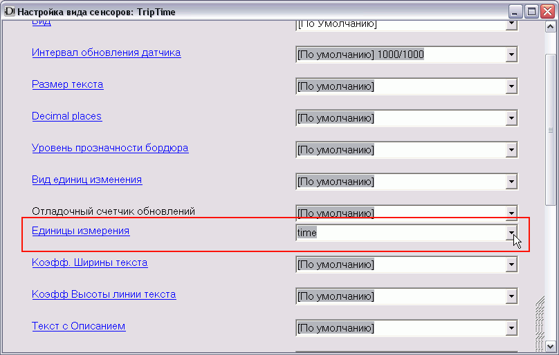

- Сообщения: 29
- Зарегистрирован: 31 июл 2014, 09:30
Re: TripTime question
user.gauge:
- Код: Выделить всё
<gauges>
<gauge
id="TripTime"
custom-units="time"
custom-units-portrait="time"
custom-units-landscape="time" />
<gauge
id="*" />
</gauges>
Thank you. I'll try but have in mind that I have stable version 1.1.1
I hope its the same
I hope its the same
- Сообщения: 29
Think thats a latest beta 1.2.10.
1.1.1 probably had that feature unimplemented.
