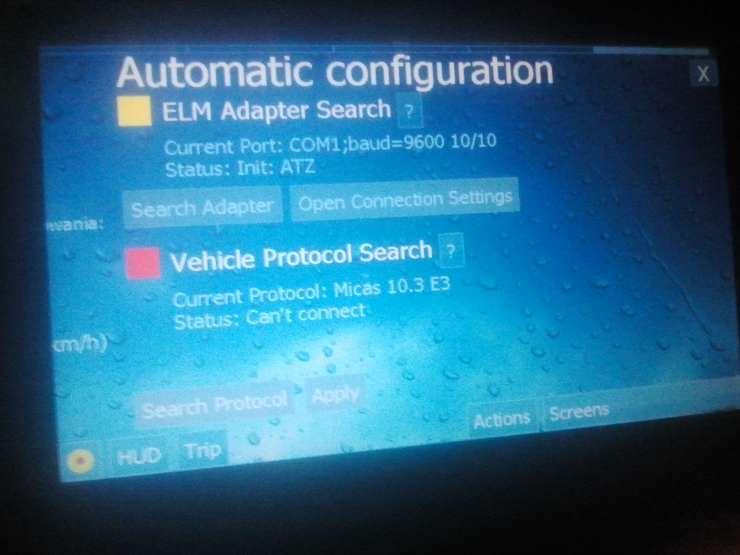

Hello I am a connection to the elm but 327 is not connected to the Vehicle protocol automatically searches but there is nothing I have to type ?? but chose not joined Toyota

Hello, please try manually setup vehicle protocol in "Vehicle Settings".
Autosearch may sometimes fail.

ok about which type to choose Vehicle Settings, Toyota does not work

what version elm327 (1.5 or 2.1) you use?

version elm327 2.1

It is necessary to check the adapter to the command ATAL
If you return a question mark, then the adapter will not work with Toyota

which corresponds to the command ATAL Elm327 ?
