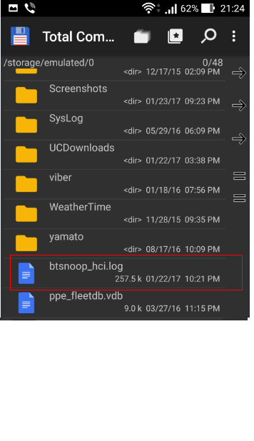

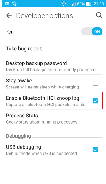

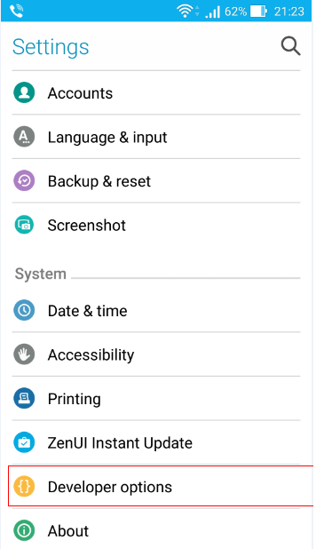

Re: Suzuki Kei (JDM)
1. enable Developer Options
4. attache file btsnoop_hci.log
2. enable bluetooth HCI snoop log
3. connect auto app sz viewer4. attache file btsnoop_hci.log
Got the Bluetooth log in the way you have mentioned...
btsnoop_hci.log
- (80.74 КБ) 2366 скачиваний
