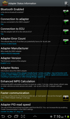

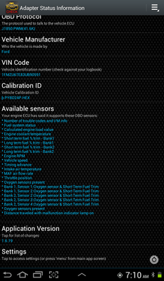

With Android 4 picked, I get no connection at all, with jni picked, the tablet locked up and would not respond even to the power button. On automatic, I did get 10 seconds of connection again.
I will attach log file and screenshots from Torque Adapter Info (for reference).
