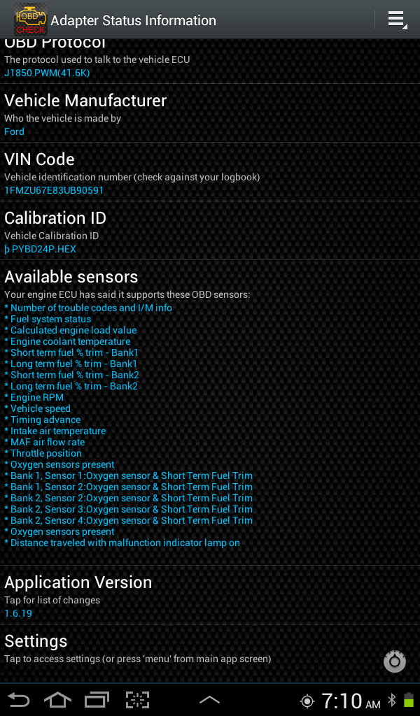

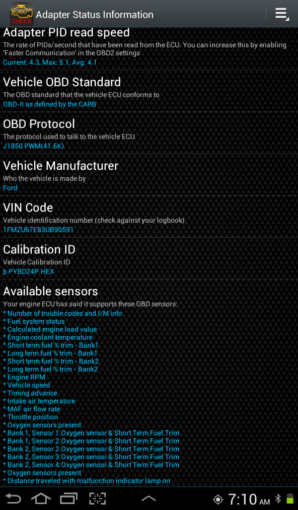

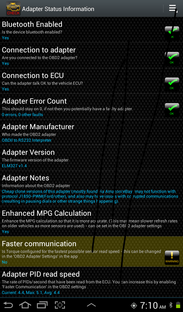

With Android 4 picked, I get no connection at all, with jni picked, the tablet locked up and would not respond even to the power button. On automatic, I did get 10 seconds of connection again.
I will attach log file and screenshots from Torque Adapter Info (for reference).
One thing I thought about this morning. I have a Supertuner XCAL flashed tune in my ECU (aftermarket program for towing a large boat). Do you think that is causing an issue? It never affected HOBDrive in Windows Mobile.

I have to come here to apologize, it was my adapter that was bad, not your program. Eventually, the other OBD program started acting funny and I bought a new adapter.
Now HOBD works just like it is supposed to!
