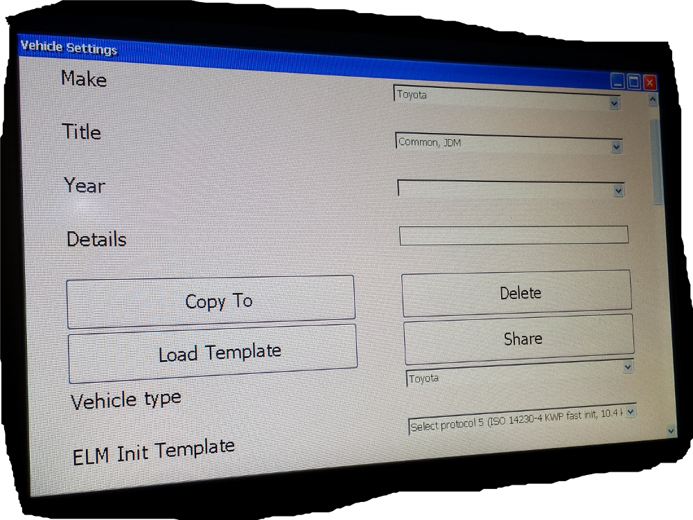

Hi,
my "problem" is that HOBDrive can not communicate with the ECU of my car, a brazilian Toyota Corolla 2011 2.0 Dual VVT-i (3ZR-FE).
Has anyone seen this problem and knows a solution?
Regards!

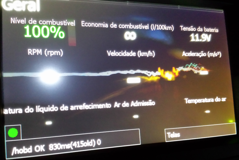

Yes Cail, I'm sure. I visualize the LEDs of the device in action during the commands sent by HOBDrive. I also tested with Torque Pro software (Android) and the result is the same, arriving just yet to talk to the ECU.
I'm putting a few pieces of logs below:
Regards!

Please try using "Toyota CAN 21" profile (Open vehicle setttings, "Type" field)
Re: HOBDrive not communicate with ECU 3ZR-FE Toyota Corolla
Cail,
I got some success by changing the "Vehicle Type" field to "Toyota" and "ELM Init Template" field to "5 Select protocol (ISO 14230-4 ...)".
But, I'm still in doubt when the MPG method because despite seeing the green circle at the bottom left, I only see information about the battery voltage. When accelerating the engine I did not get results on the screen.
Greetings!
Greetings!
Hi guys,
I have not received a return of support department but has found the useragent.dll file and reused in version 1.1.95-Beta folder...
Cail: The CAN21 setup did not work on my car!
Even getting into the mode of self-configuration, not an ideal configuration has been found.
In version 1.1.1 I select the protocol 5 for Toyota JDM and reaches to the noise from the ignition catching but not shows the sensor values.
In version 1.1.95-Beta I select the protocol 5 for Toyota JDM and only gives the sound of misfire.
Good job!
Looking forward!
Good job!
![Подмигивает ;)](./images/smilies/icon_e_wink.gif)
Looking forward!
HOBDrive 1.1.97-Beta + RoadRover MotorOne(M1) WinCE6 800x480 + ELM327BTmini + Kevler Bluetooth(generical) + Toyota Corolla 2011 XEi FLEX 2.0 Dual VVT-i (3ZR-FE)
This means your toyota has some custom unknown ECU.
Could you try choosing different "Toyota JDM" types? There are couple of elm init strings with "JDM" word in them - try choosing different items as well.
If that not help, please post you log.txt file here.
Cail,
I can swap the "JDM" strings and test immediately or have to restart the HOBDrive?
And the auto-configuration mode? Should not find the right setting?
Hug!

You may check for result immediately after pressing "OK" with new settings.
Autoconfig can't help in complex cases, but you may try it. Check if it can find any setting with some data except voltage. Make sure you have ignition/engine on.

Hello Cail,
I received my new device and everything worked!
See below:
Regards!!
See below:
- Код: Выделить всё
[INFO] 25/6/2014 09:35:18.013[HOBD] HOBD 1.1.97 Thu 04/17/2014 03:18 AM
[INFO] 25/6/2014 09:35:18.230[HOBD] Env: 3.5.7283.0
[INFO] 25/6/2014 09:35:20.299[HOBD] SN: 00540054-0034-0058-0030-545434583042445F3000
