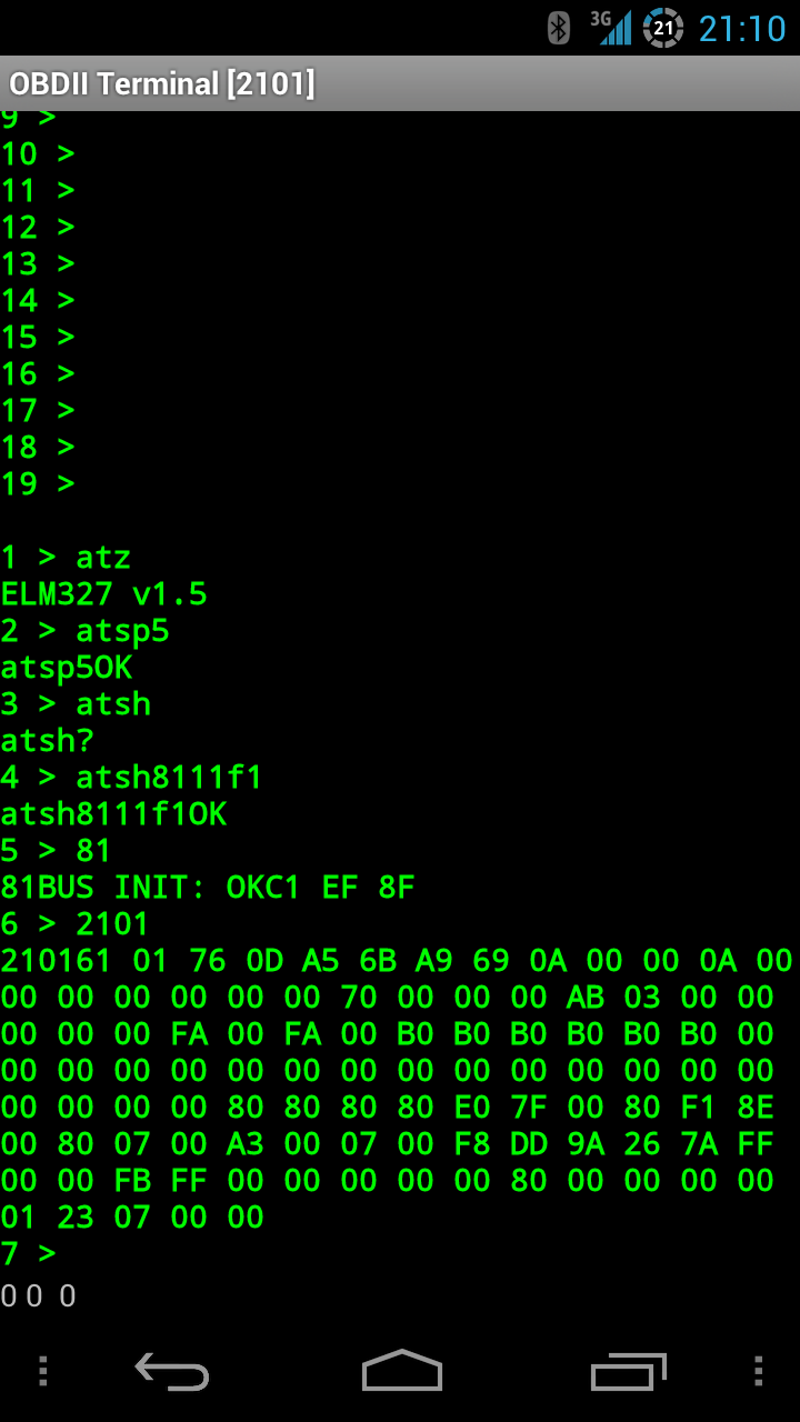

I've been reading a lot in the past two days, mostly about ELM327 and KWP2000 protocol.
I managed to connect to the ECU using the following commands.
ATZ
ATSP5
ATSH8111F1
81
But the OBD-II PIDs (0100, 010C ..etc) won't work because the car is not OBD-II, however the car responds to the command 2101 with a long string (around 100 bytes long), lots of values change when I start the car which probably mean that these are the Hyundai PIDs.

For some weird reason the Coolant value is always being read at 88c (80-40) while the others are always -40 or 0.
I have checked using obd terminal that the value was actually 7f which mean with the offset of -40 the end result should be 87c not 88c.
When I send the 2101 command using terminal:-
>2101
The ECU responds with:-
61 01 7B 0D 71 8C 83 82 0A 00 00 0A 30 ...etc
The 71 is the coolant sensor, 83 is the Intake temperature sensor and the 30 is the throttle position.
Is it right that I put the coolant as <value-4>, Intake as <value-6> and throttle as <value-12>??
Edit:-
HandleReply: FF 00 00 00 00 00 80 00 00 00 00 01 FF 06 00 00
[TRACE]
That happens only in HOBD, in OBD terminal the ECU reply properly. Whats wrong?

In terminal the only commands I put to connect are:
ATZ
ATSP5
ATSH8111F1
81
and then get data using 2101.

HOBD log is attached.
Also OBD terminal (Android app) screenshot is attached which shows proper ECU reply using the same commands.
Also Torque Pro shows proper output.

Сообщения: 4323
Re: Hyundai Coupe/Tuscani
Thats strange indeed!
Could you try putting the next init string:
ATZ;ATSP5;ATSH8111F1;81;2101
and giving log.txt again
