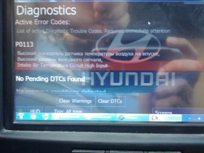

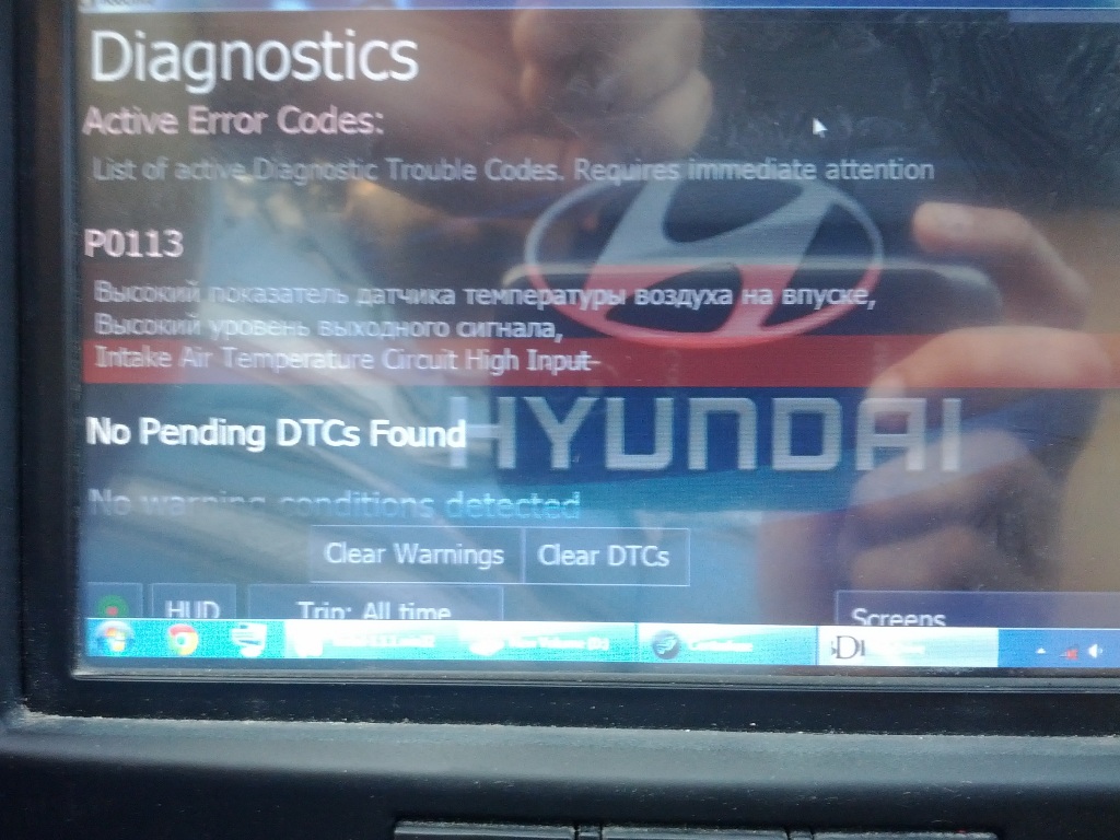

I disconnected the Intake Air Temperature sensor and it gave me P0113 which is correct.
Description was fine also but there were 3 lines total (2 Russians? and 1 English), I took a picture of it and its attached.
