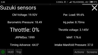

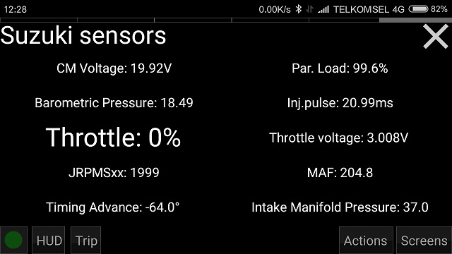

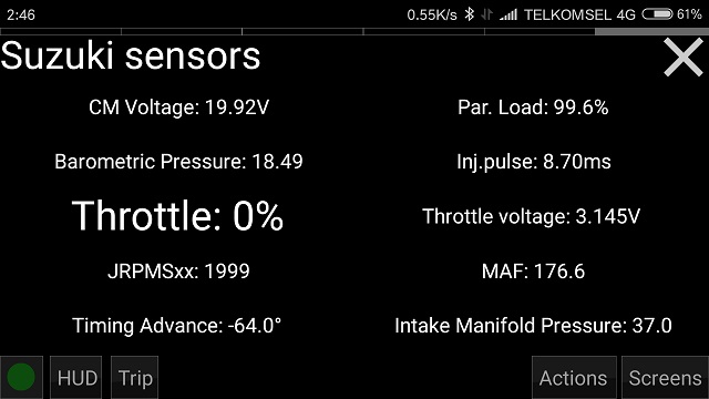

With HobDrive Connection to ECU is ok, green circle in bottom left corner. But almost all sensor reading was a mess.
Throttle Position always zero and not response to accelerator pedal. Coolant Temp with negatif value, Air Temp with too high value, RPM and speed is jumping all over the place even when engine is not started. Fuel per Hour also too high even with engine off.
Sensors read is invalid

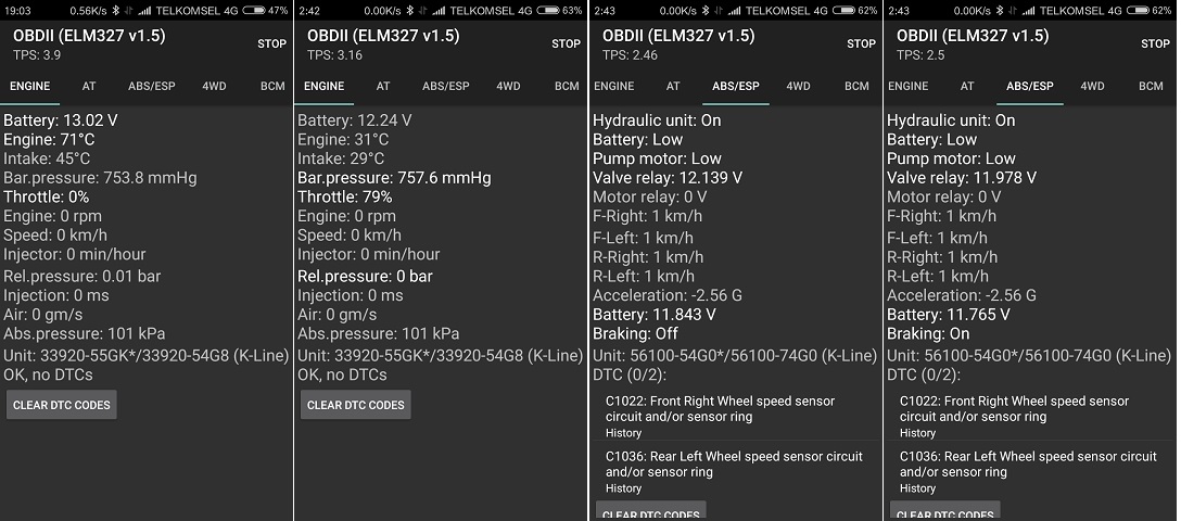

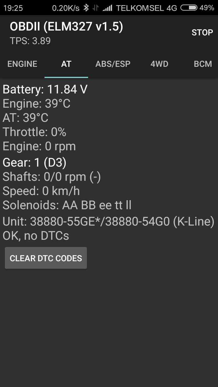

But my confussion is when I tried another software, everything is perfect, TPS, ECT, IAT, rpm, vehicle speed, all reading is perfect. But since it's display too basic not like hobdrive, I prefer hobdrive to run.

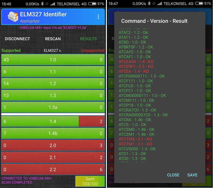

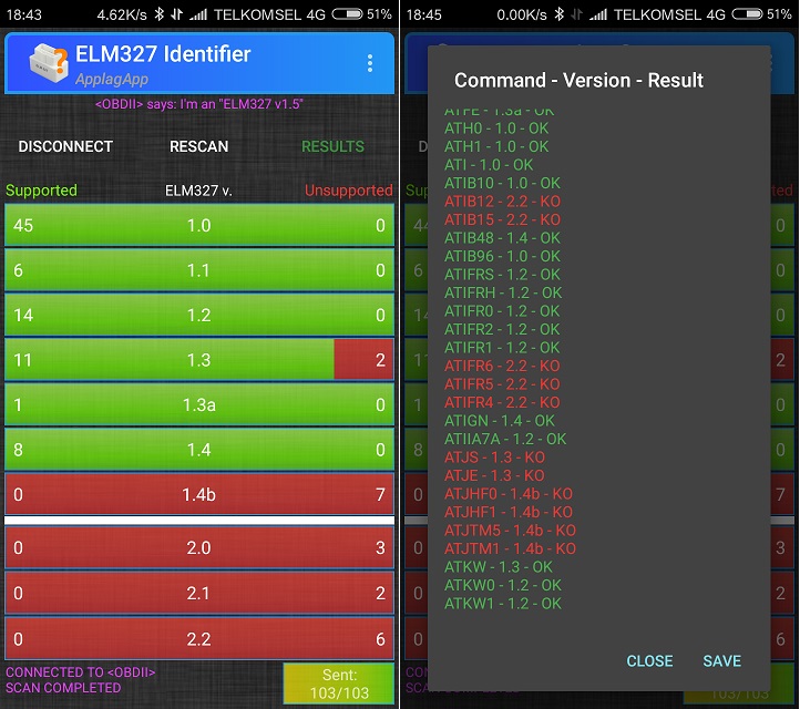

I checked with ELM327 identifier and find out in version 1.3 there are 2 unsupported command : ATJS, ATJE
OBDII ELM327 generic - unsupported command
Is it because 2 unsupported command that make sensor reading is not working ?
This is ELM327 identifier when using OBDLINK MX (that work perfectly with hobdrive) :
OBDLINK MX - ELM327 identifier result
This is generic OBDII ELM327 v1.5 using another software, tried with gas pedal off/on and brake pedal off/on :
Another software test using generic ELM327

btw tried another ELM327 v1.5, tes using ELM327 identifier, all command from 1.0 to 1.4 supported without exception. But both sz viewer and hobDrive can't connect to ECU.....

singachu123 писал(а):With HobDrive Connection to ECU is ok, green circle in bottom left corner. But almost all sensor reading was a mess.

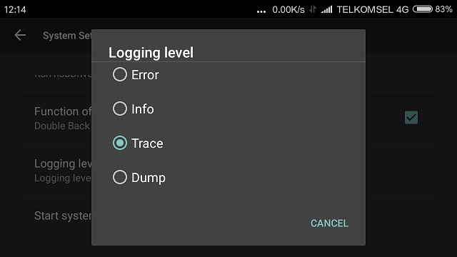

Do the following with the adapter 1.5 to Hobdrive:
-Screens/settings/System settings/Logging level - Trace
-Screens/settings/Vehicle Settings/Ecu Settings:
Vehicle Ecu Type - Suzuki_JDM_KWP11
ELM Init String - ATPPS; ATSP5; ATAL; ATIB10; ATSH8111F1; ATST32; ATSW00; ATFI;
-Connect to auto
-Screens/Suzuki sensors. Make printscreen
-load file log.txt from hobd

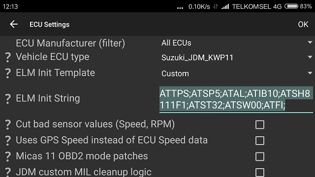

Hello,
preparation :
setting to trace
setting to trace
setting ECU and Init string
suzuki sensor screen shot :
Suzuki Sensors screenshot

Re: Suzuki Aerio (Indonesian market) ECU ok, error sensor va
Hello.
Your adapter does not correctly return data - an extra byte at the beginning of the answer. Let's try to get around this problem programmatically.
And you did not enter the correct command ATTPS; but must ATPPS;

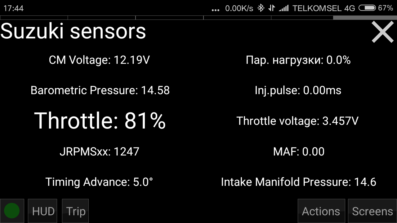

Сообщение singachu123 »
wow, it's work, very nice !
suzuki sensors
suzuki sensors
log test 2.txt
(182.33 КБ) 2815 скачиваний
Thanks a lot.
