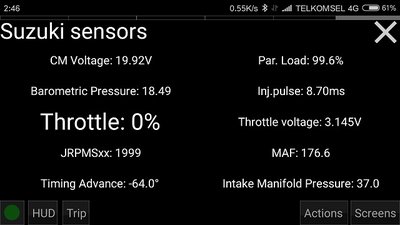

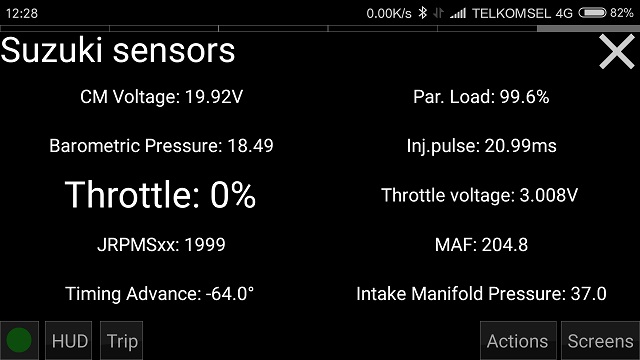

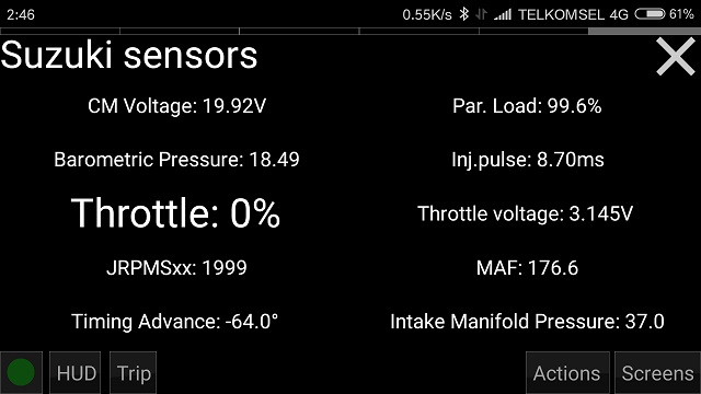

With HobDrive Connection to ECU is ok, green circle in bottom left corner. But almost all sensor reading was a mess.
Throttle Position always zero and not response to accelerator pedal. Coolant Temp with negatif value, Air Temp with too high value, RPM and speed is jumping all over the place even when engine is not started. Fuel per Hour also too high even with engine off.
Sensors read is invalid

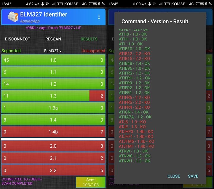

I checked with ELM327 identifier and find out in version 1.3 there are 2 unsupported command : ATJS, ATJE
OBDII ELM327 generic - unsupported command
Is it because 2 unsupported command that make sensor reading is not working ?

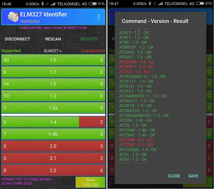

This is ELM327 identifier when using OBDLINK MX (that work perfectly with hobdrive) :
OBDLINK MX - ELM327 identifier result

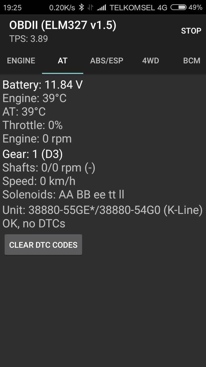

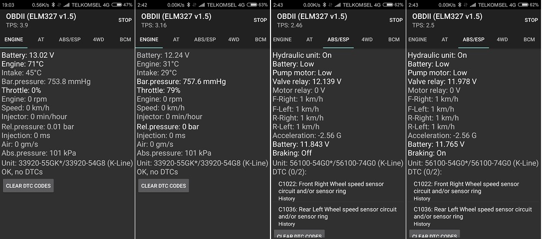

This is generic OBDII ELM327 v1.5 using another software, tried with gas pedal off/on and brake pedal off/on :
Another software test using generic ELM327

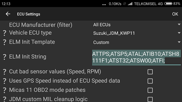

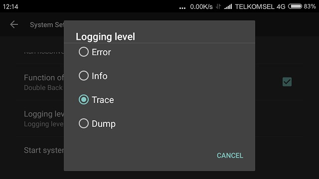

Do the following with the adapter 1.5 to Hobdrive:
-Screens/settings/System settings/Logging level - Trace
-Screens/settings/Vehicle Settings/Ecu Settings:
Vehicle Ecu Type - Suzuki_JDM_KWP11
ELM Init String - ATPPS; ATSP5; ATAL; ATIB10; ATSH8111F1; ATST32; ATSW00; ATFI;
-Connect to auto
-Screens/Suzuki sensors. Make printscreen
-load file log.txt from hobd

Hello,
preparation :
setting to trace
setting to trace
setting ECU and Init string

Result still the same, it's test with just key on, engine not started.
regards,
singachu

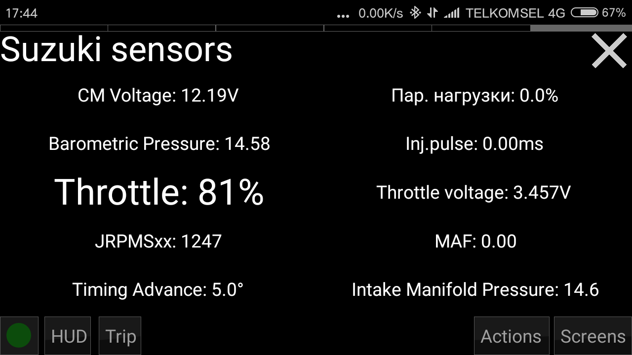

Re: Suzuki Aerio (Indonesian market) ECU ok, error sensor va
Hello.
Your adapter does not correctly return data - an extra byte at the beginning of the answer. Let's try to get around this problem programmatically.
And you did not enter the correct command ATTPS; but must ATPPS;

wow, it's work, very nice !
suzuki sensors
suzuki sensors
log test 2.txt
(182.33 КБ) 2869 скачиваний
Thanks a lot.
