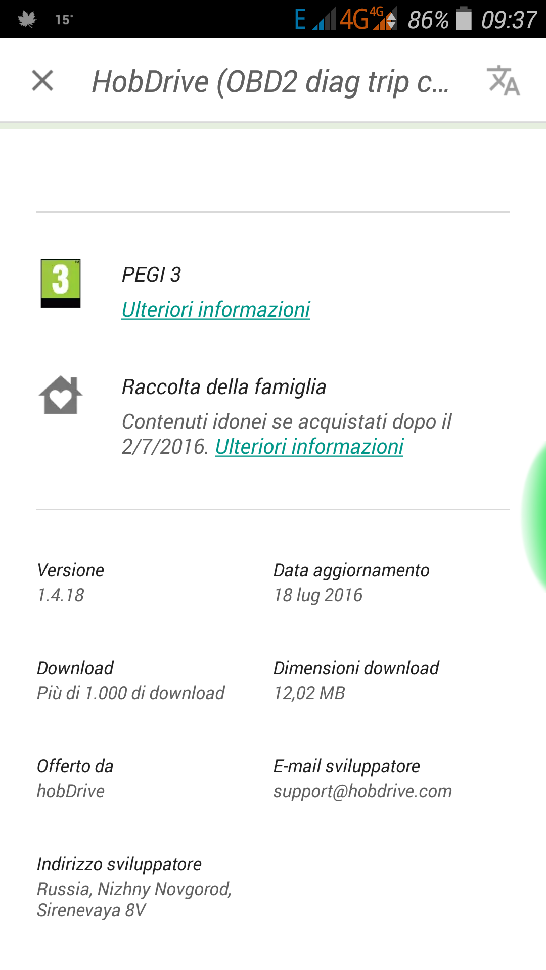

To get 1.4.19 it is necessary to become a beta tester: https://play.google.com/apps/testing/hobdrive.android
You can set 1.4.18.
The main switch on the trace.
Before you all worked fine, and in one day stopped working? I understand you correctly?
You can set 1.4.18.

Re: Hyundai accent 2006 1.4
I was already but does not exist as the 19 by screenshots shoot
While set 1.4.18. After a while (depending on google) you the latest beta version (1.4.19) will be available
